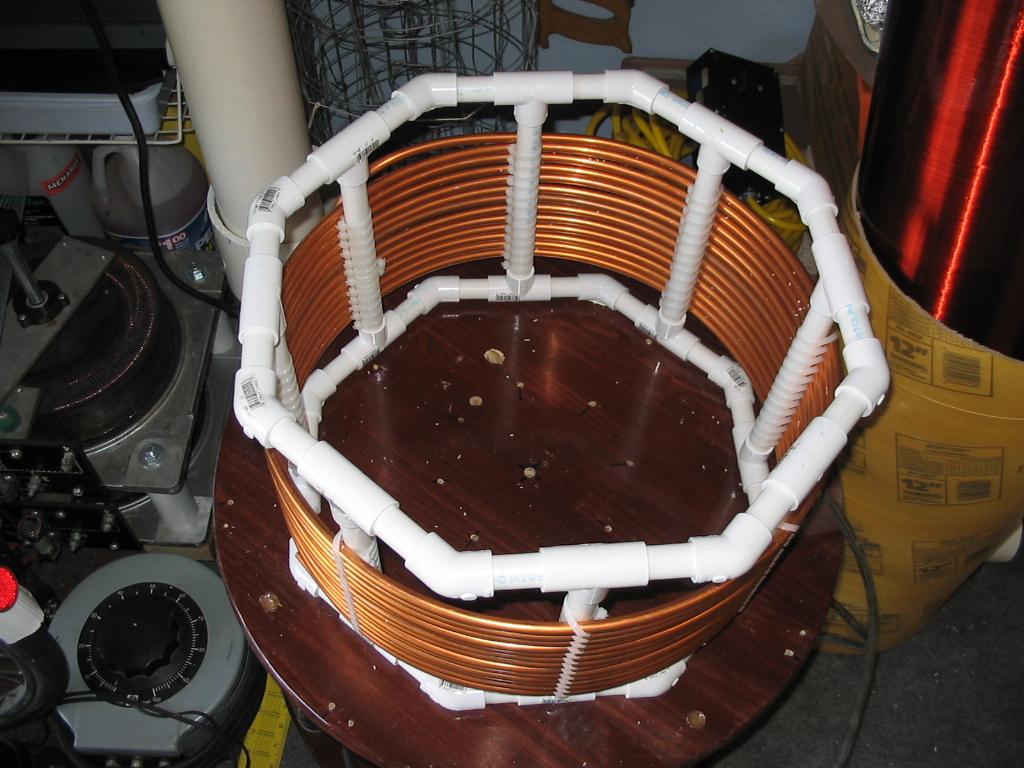

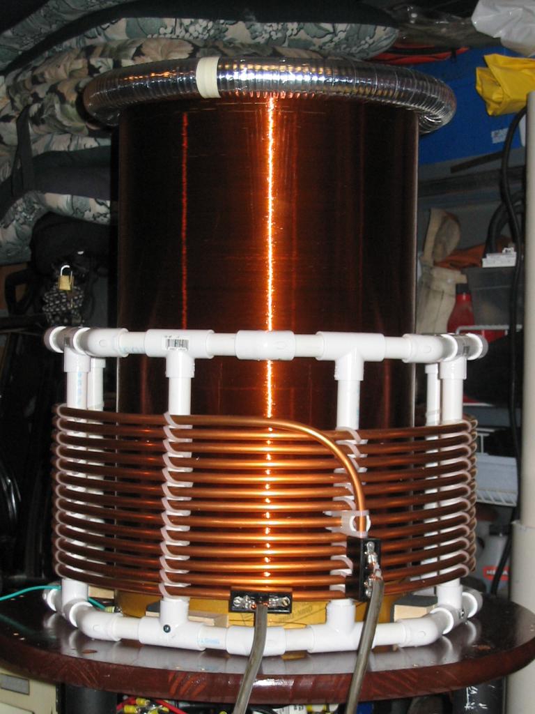

L1 (primary): 18" diameter with 12.8 turns of 3/8" Cu. tubing, ~.2" spacing between turns.
C1 (tank C): .36uF 10kv MMC.

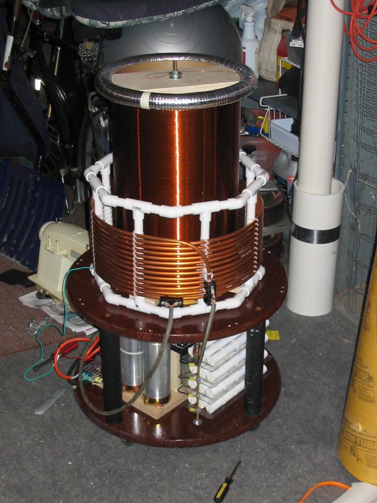

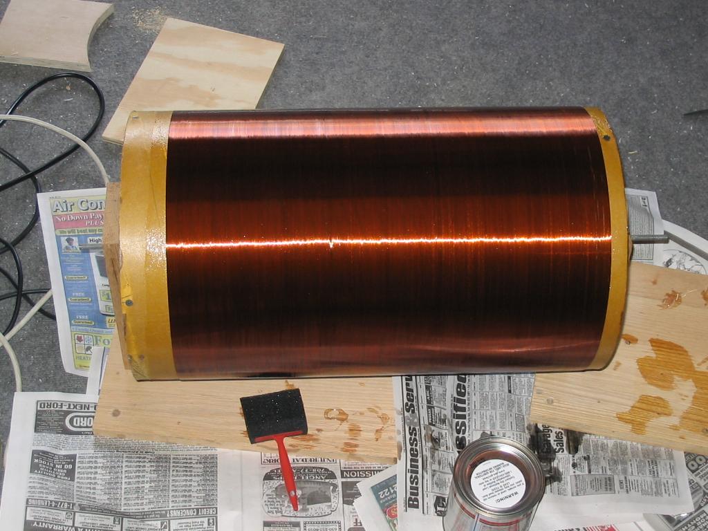

L2 (secondary): 12.75"x19" winding of .035" diameter magnet wire (21.5awg I believe) on sono-tube.  1.5" diameter corona ring on top.
L3 (tertiary): Undetermined, but likely in the 150mH range.

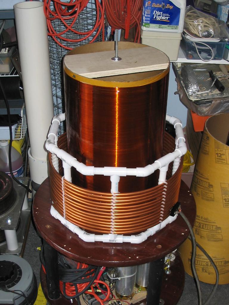

Winding the secondary with my usual jig. Extra thanks to fellow coiler, Jeff Larson, for the (used) magnet wire. This wire has quite a history now!

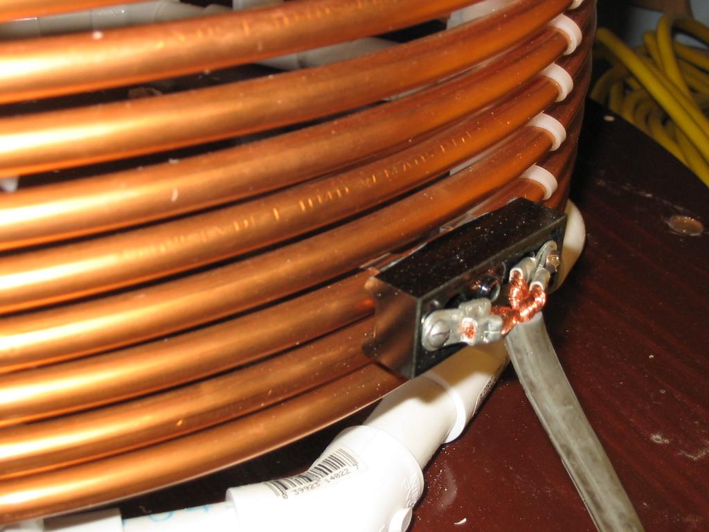

The primary.  This is the most rigid primary I have ever made, it seems just about indestructable.

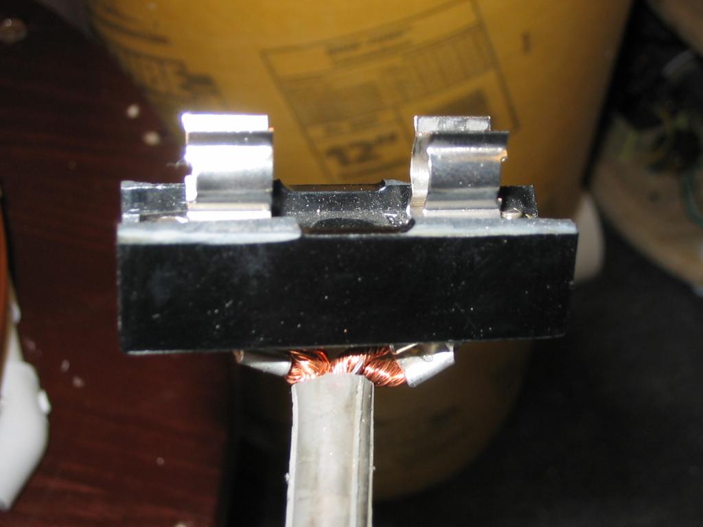

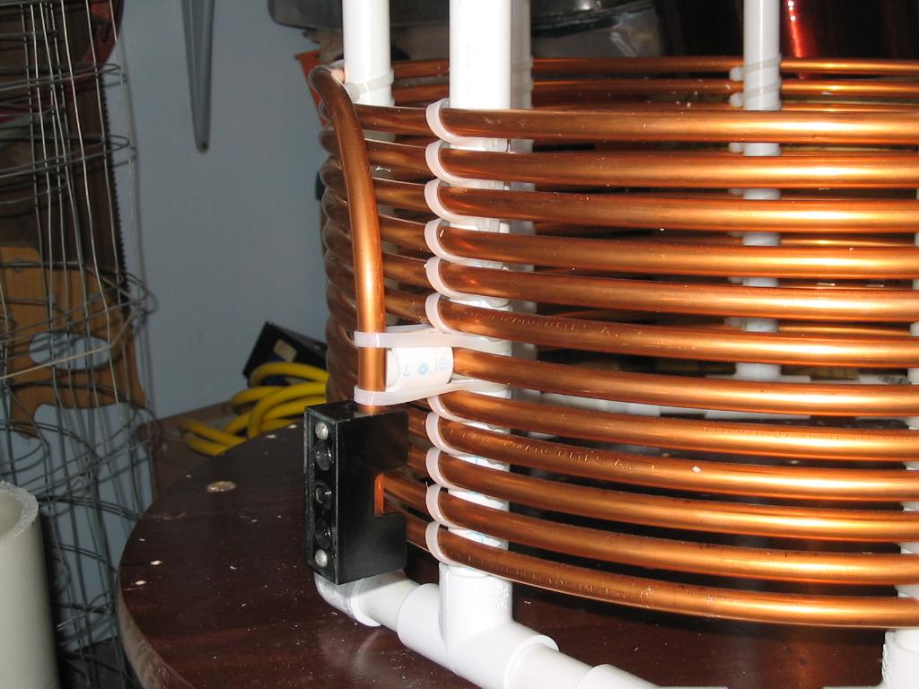

Fuse clip modified for my primary tap connection.

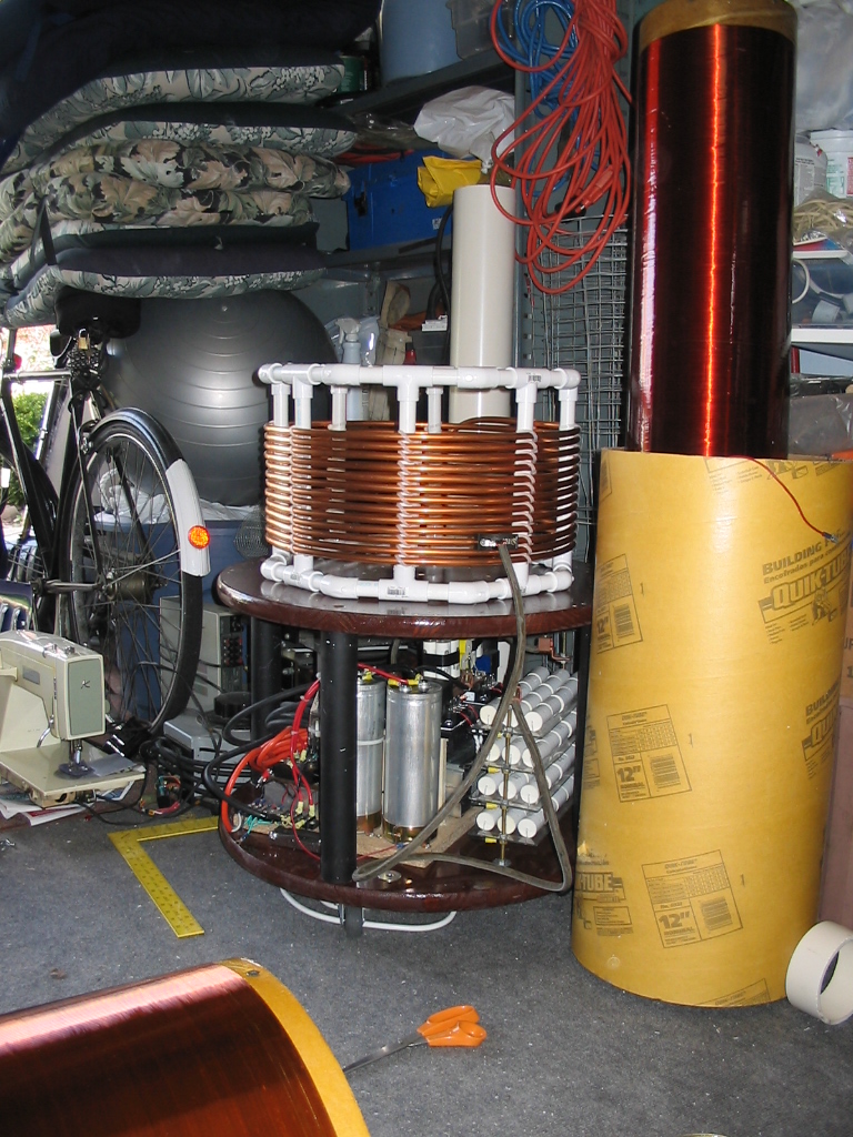

Here are some pics of the driver unit all together.  I left a small break in the corona ring to prevent any power loss from it being a shorted turn, and in particularly close proximity with the secondary.

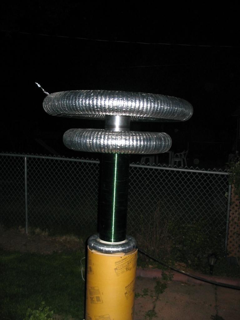

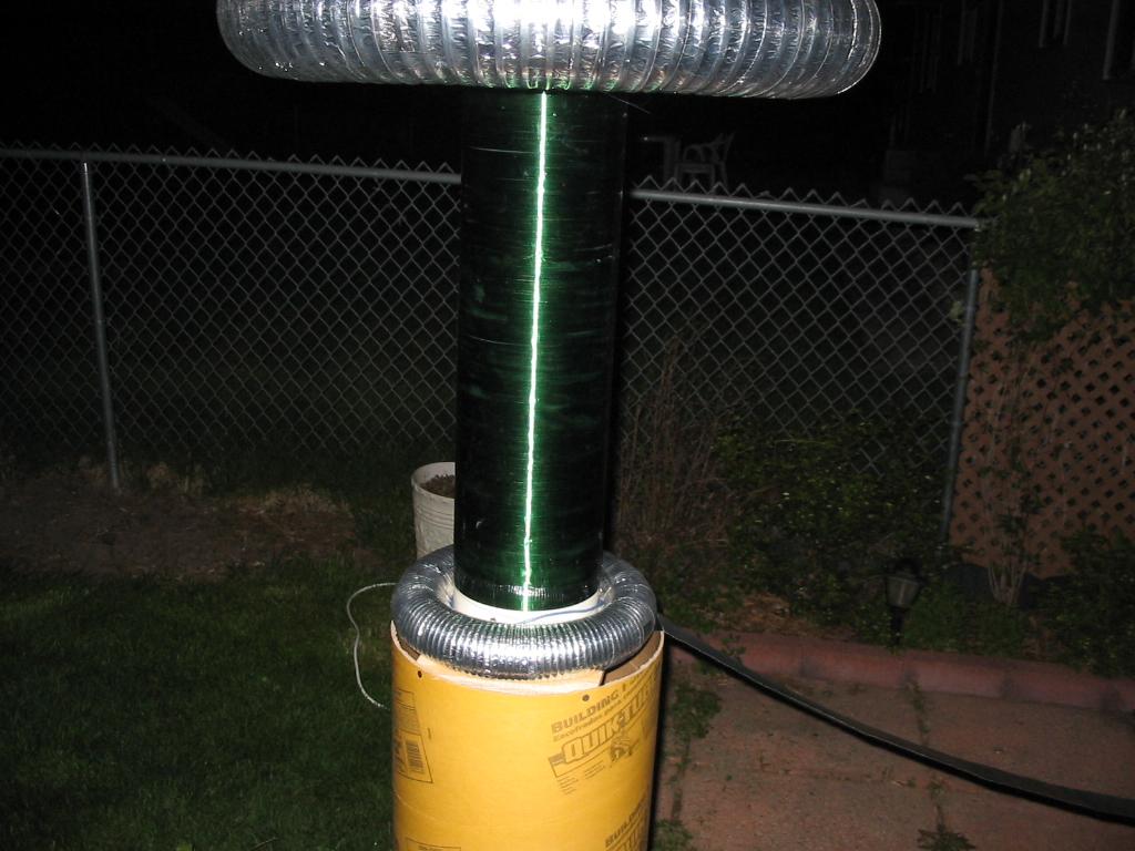

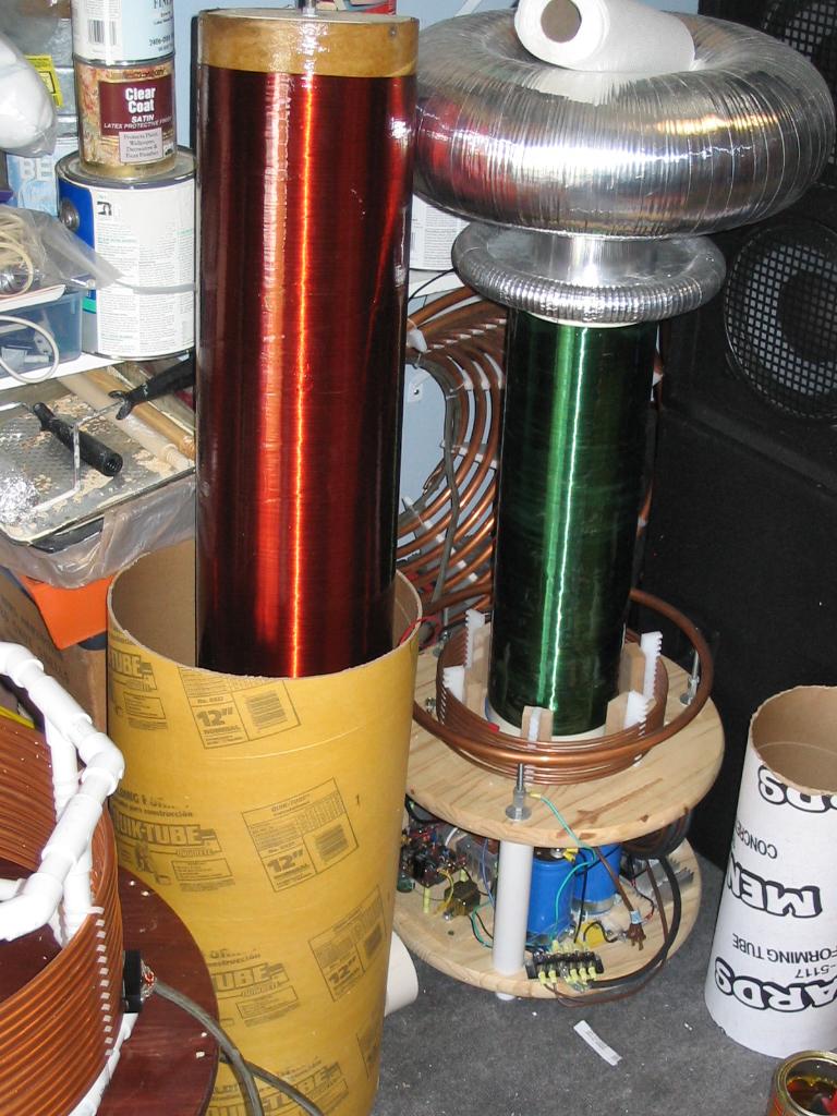

The 2 candidates for tertiary windings. Red coil: 8"x45" of 26awg.Green coil: 6.5"x21" of 30awg.  I would really like to see 10' from the 21" coil :-).

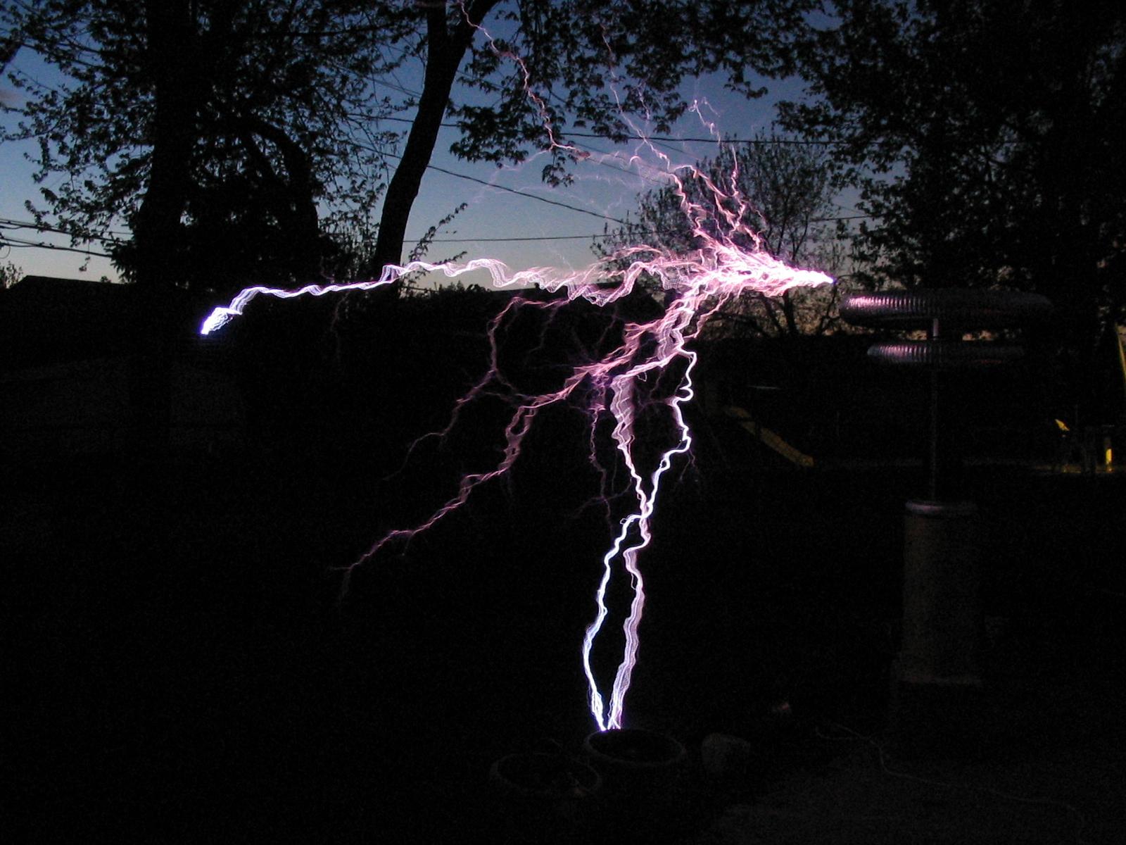

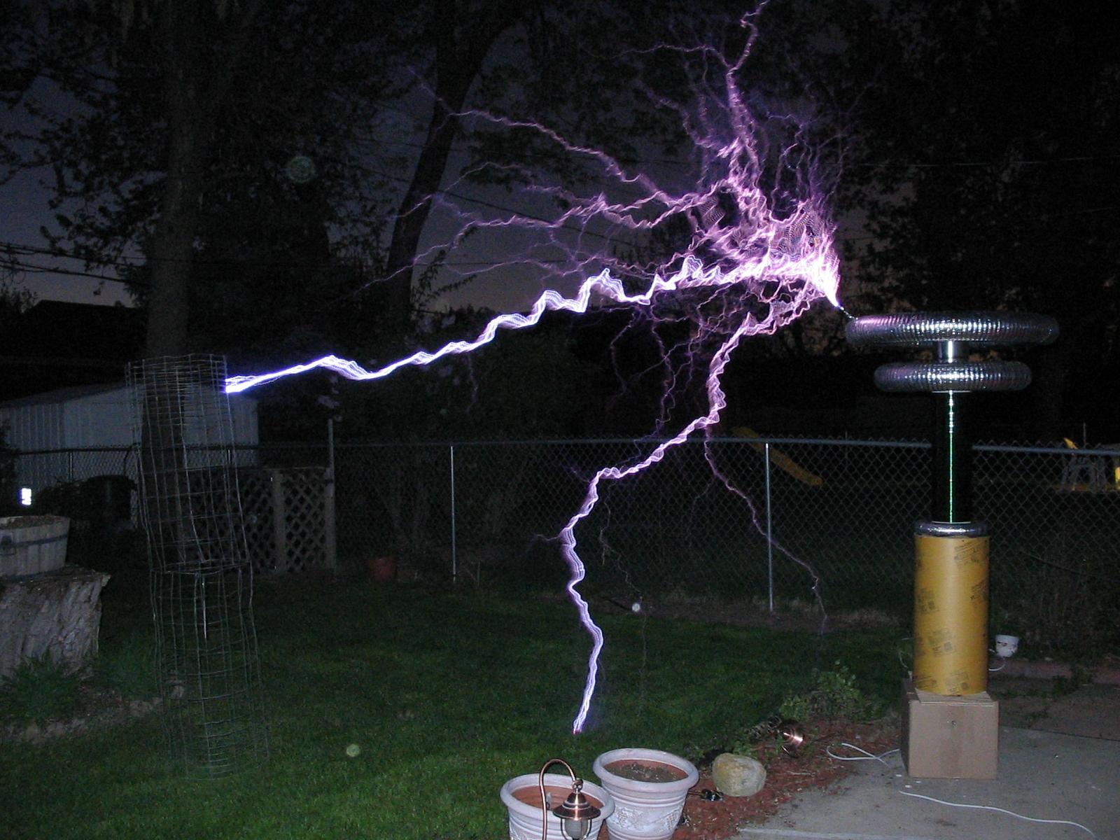

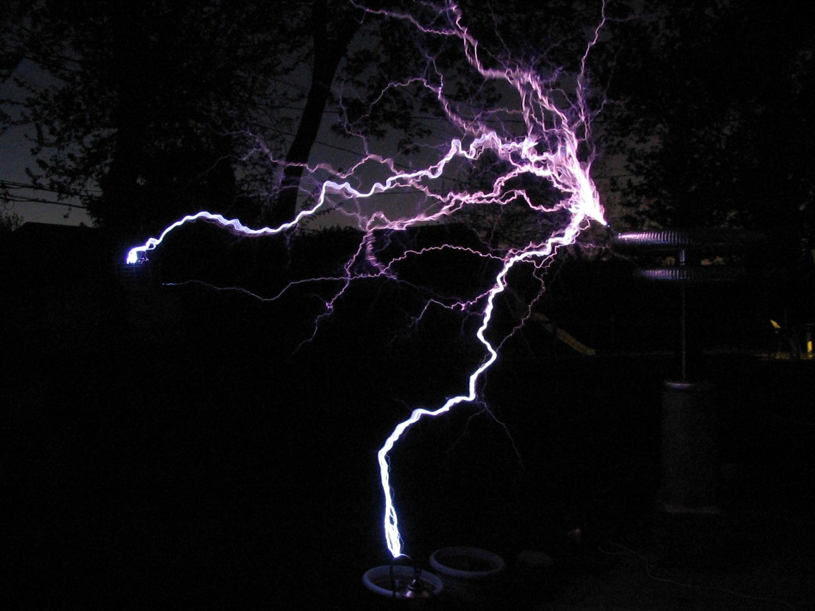

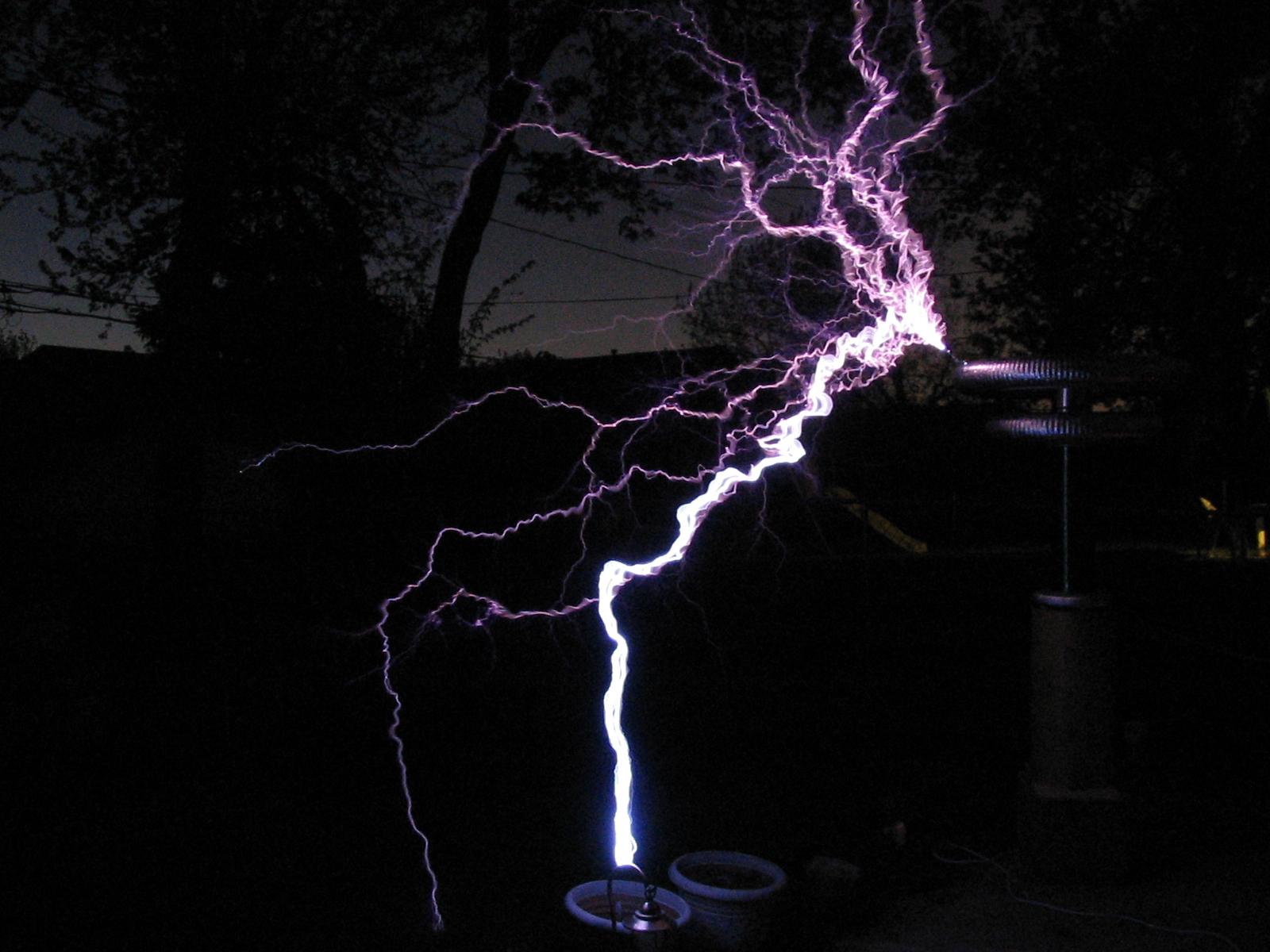

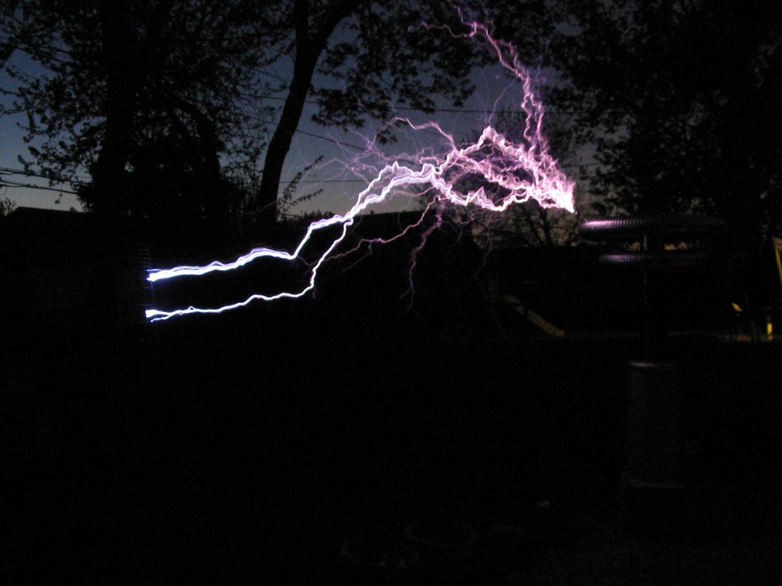

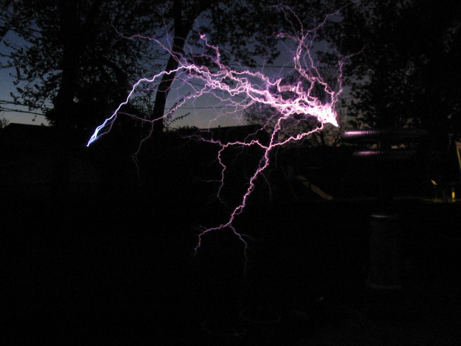

First Light (4/30/05):

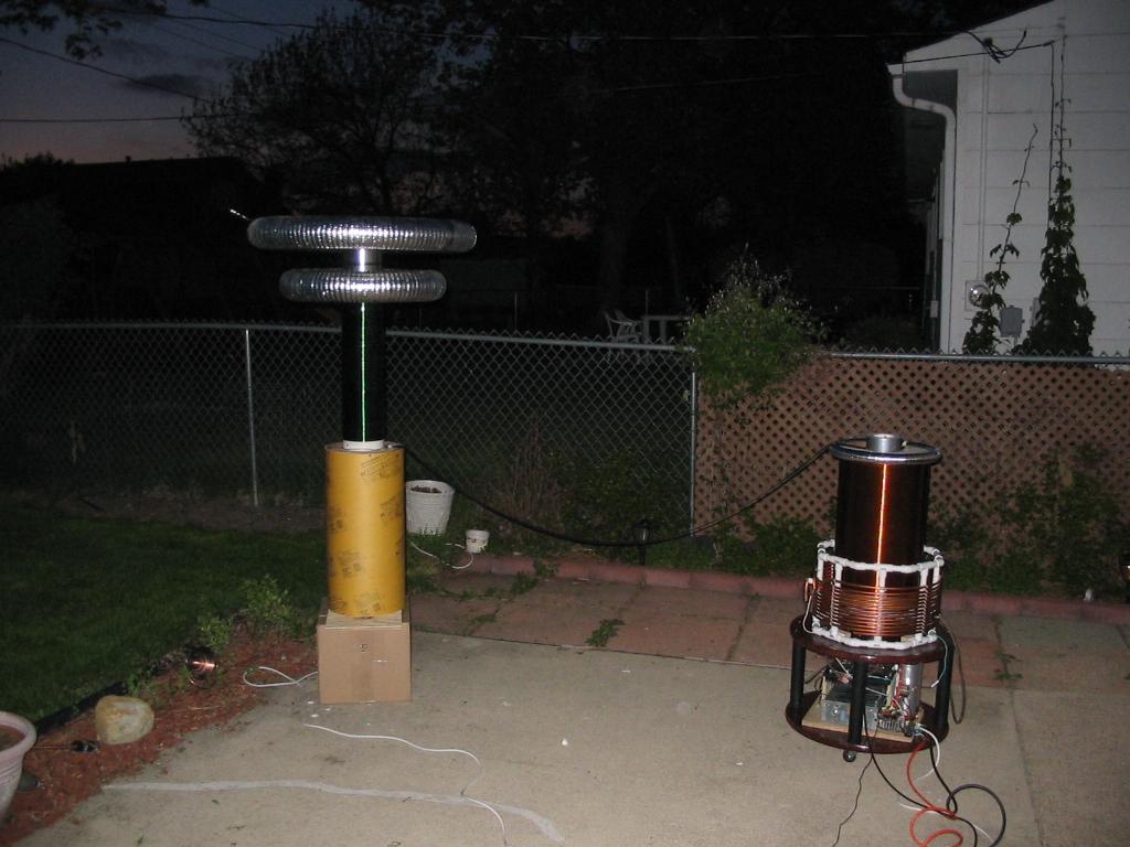

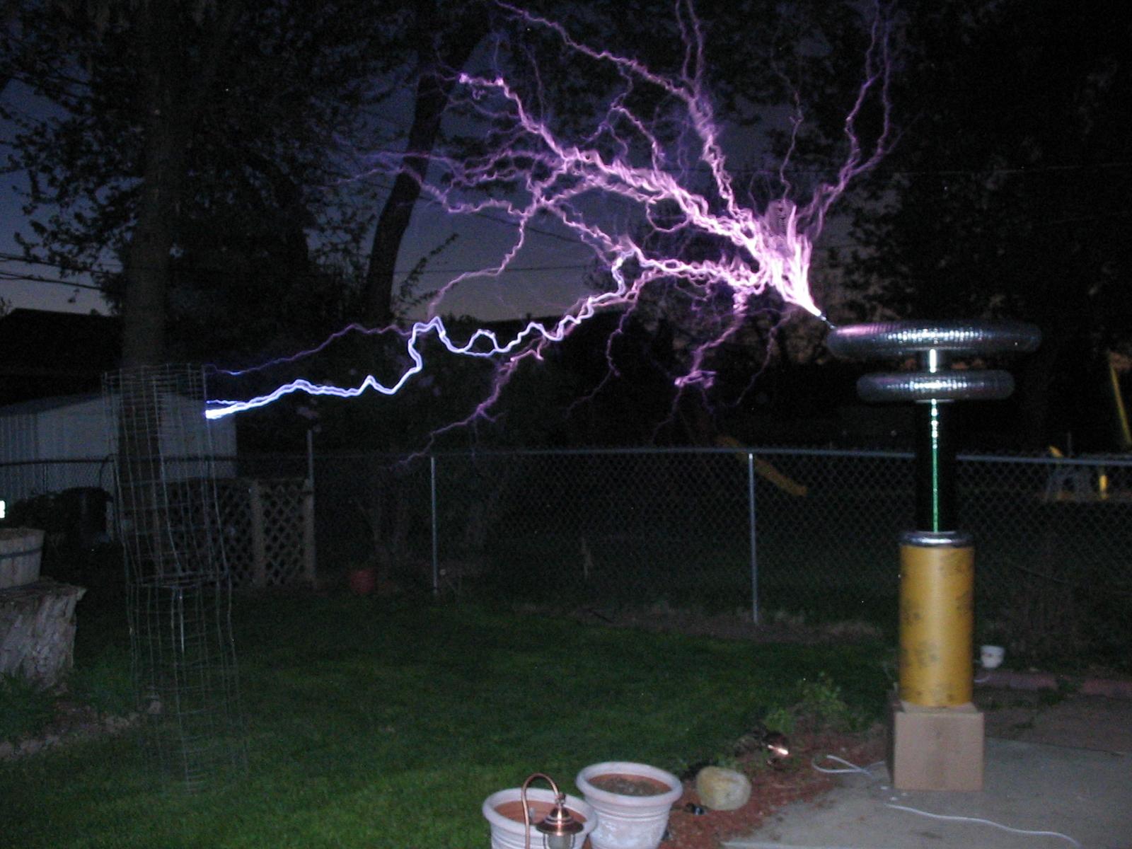

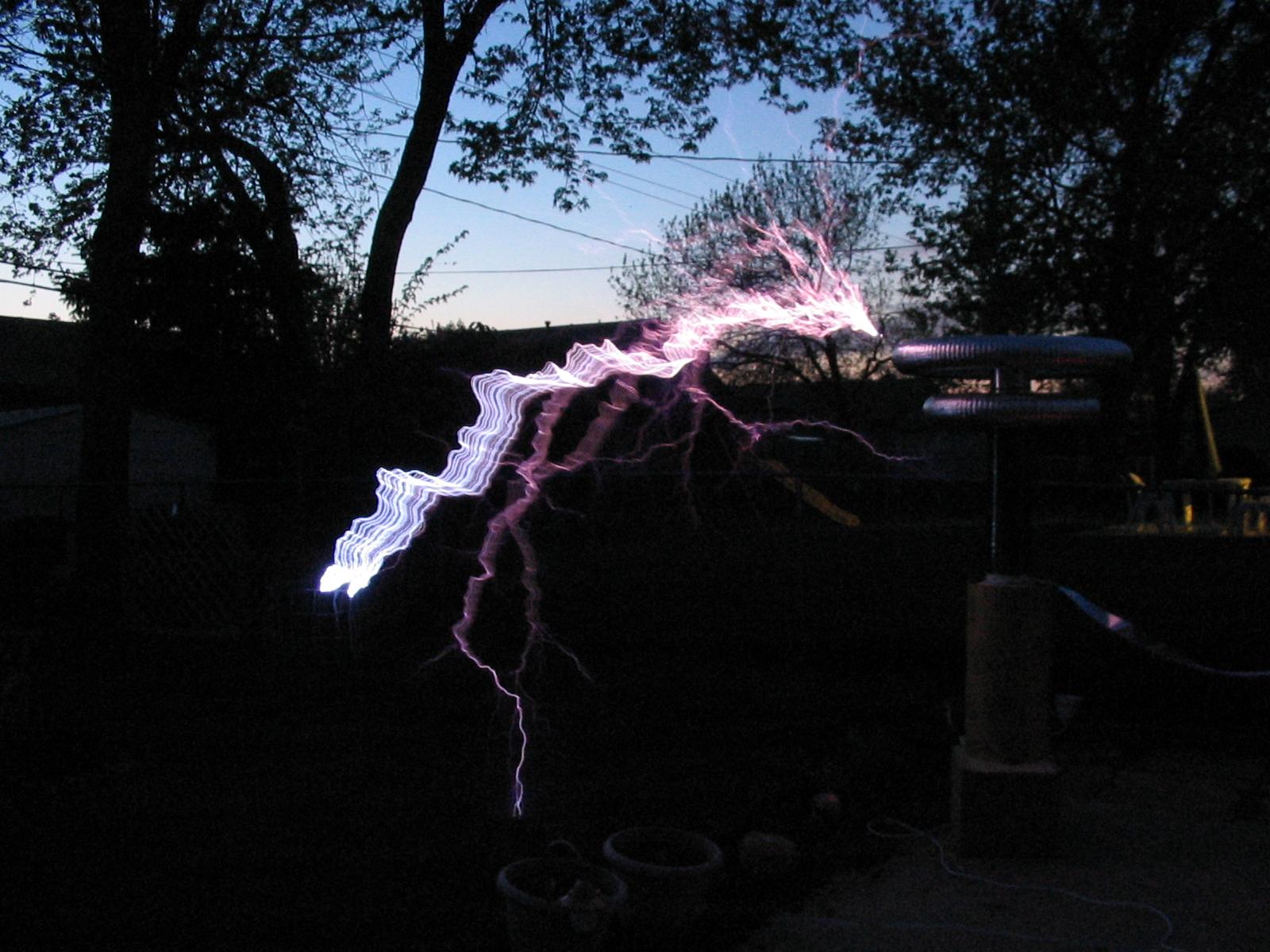

Well, I finally got around to dragging the whole thing out to the backyard and firing it up.  After raising my secondary up 6" from its initial height, I was finally able to avoid flashover between the coils.  The primary current was hitting about 850A and the limiter was cutting in a lot at full power, limiting me to about 9' max (the horizontal strikes to the metal caging was measured to 108" exactly :-) ).  That's pretty darn good for a 21" tall resonator!  I noticed a lot of corona from end to end on L3, so I stuck a spare toroid under it, and that seemed to tame everything.  Enjoy the pics now!
Resonator with 36" top toroid.  Breakout point was ~6.5' above the ground.
