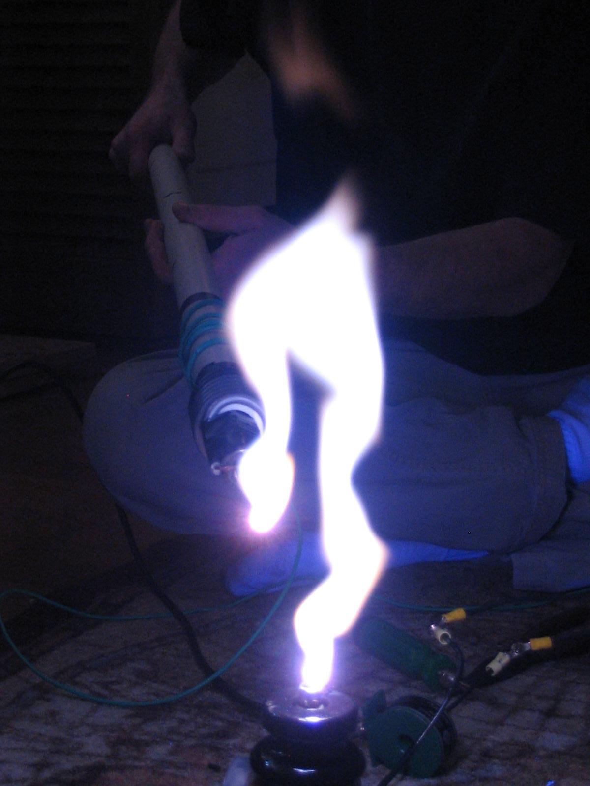

 Here is one of the best arcs we ever produced from this transformer.  Lots of current, but very little short circuit voltage.  Soon after this arc, the inverter dies again.  I've had it with this!  At about this time I began researching the SLR (series load resonant) topology.
These are flames left over just after an arc extinguished (yes, the arc is HOT).

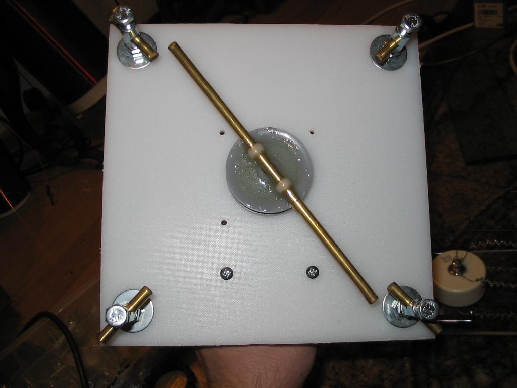

Some 30" sparks.  Nothing too impressive.  I believe the poor performance is due to the limited energy storage of the MMC.  The transformer was only running about 500W at this point.  Better results to come later (hopefully!).
